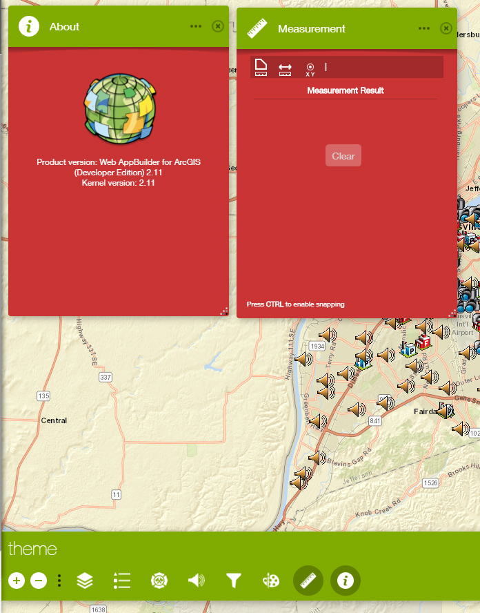

RobertScheitlin__GISP
MVP Emeritus
Emily,
  Here is my rule at the bottom of my Dart theme common.css file:
.dart-panel .panel-bg {
  background-color: #c93434;
And what the app looks like:

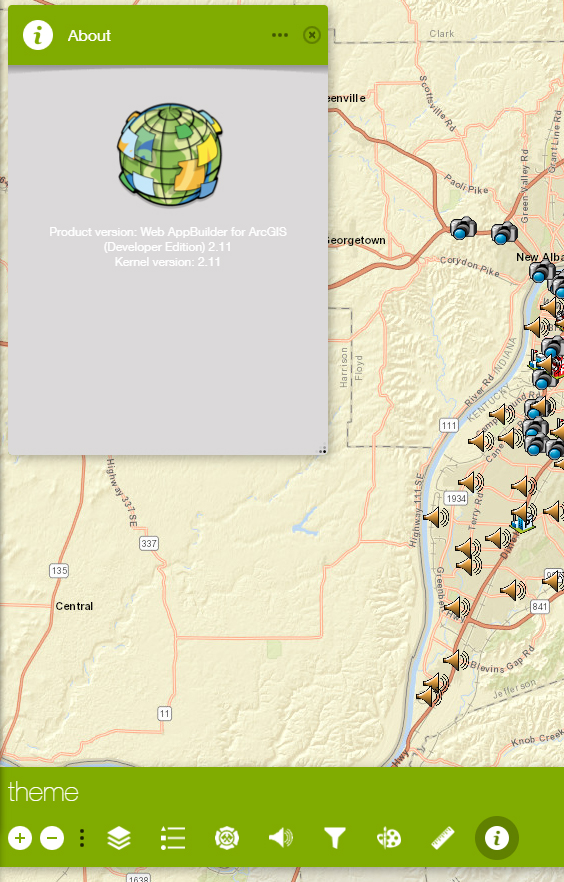

MVP Emeritus
Emily,
  OK this is what I get when I use your file:
EmilyCaruccio
That is exactly what I want.
I'm stumped as to why it is not reflected in my web app.
