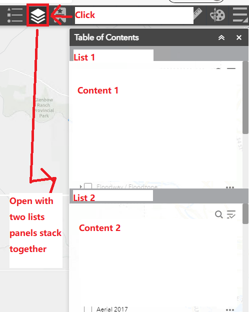

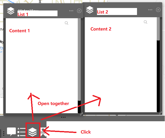

 To clarify the effect I am looking for, here is what I get for now.
The effect I am looking for is something like below, for group widget button:
Any idea may help.
