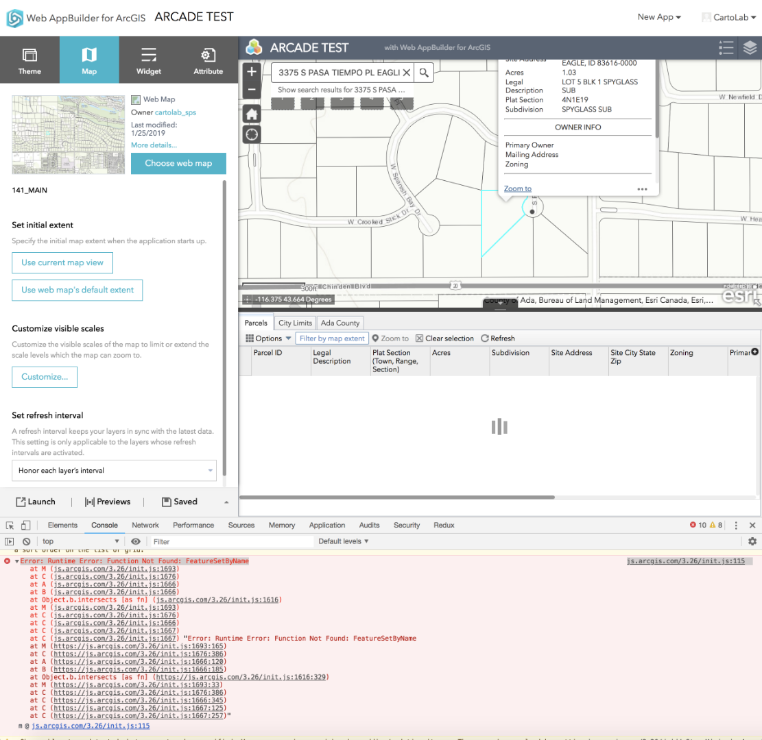

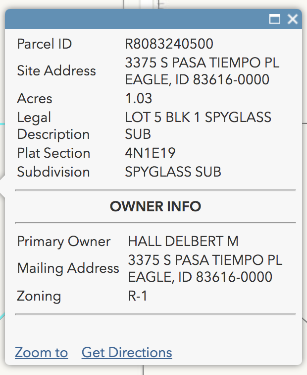

I have a popup that includes Arcade Expressions, which appear just fine in the AGOL web map (The Arcade expressions populate the items under Owner Info:
But when I add this web map to a WAB Dev Edition application (v2.10), the arcade expressions do not appear. See the Owner Info section in the popup in the image below. There is no console error when this occurs.
However, when opening the Attribute Table widget, data does not render and the Javascript console does produce an error:
js.arcgis.com/3.26/init.js:115 Error: Runtime Error: Function Not Found: FeatureSetByName

XanderBakker
Esri Esteemed Contributor
I think what you have found is that the FeatureSetByName was not yet implemented in version 3.26. In ArcGIS Online this function was release in the December update, so it is quite recent. In Enterprise it will be include in the 10.7 version which will be release in March. In case you can resolve the incompatibility issues in 3.27 that would be the way to go if you want to use the FeatureSetBy* functions in WAB Dev edition.

BatesRambow2
I did notice that pointing the deployed app's API version to 3.27 instead of 3.26 (which is what WAB 2.10 points to) seems to fix the problem with Arcade expressions not appearing. However, doing that causes some compatibility issues with other widgets. I also can't find anything that indicates theres a problem with these Arcade expressions in 3.26, so I'd prefer to find a solution that uses that version.

BatesRambow2
Seems that you're right. Thanks. I managed to get the other minor issues caused by the switch figured out, so it seems to be working.
