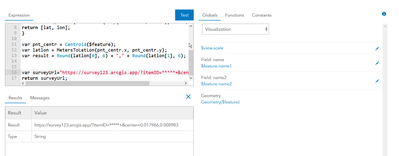

With ArcGIS Enterprise 10.7.1, have a web map with a polygon layer, and an App created using the Web AppBuilder with that web map. The polygon layer has a custom attribute defined with following Arcade code. When open attributes table in the App, that polygon layer can't show attributes but got stuck.
function MetersToLatLon(mx, my) {
var originShift = 2.0 * PI * 6378137.0 / 2.0;
var lon = (mx / originShift) * 180.0;
var lat = (my / originShift) * 180.0;
lat = 180.0 / PI * (2.0 * Atan( Exp( lat * PI / 180.0)) - PI / 2.0);
return [lat, lon];
var pnt_centr = Centroid($feature);
var latlon = MetersToLatLon(pnt_centr.x, pnt_centr.y);
var result = Round(latlon[0], 6) + "," + Round(latlon[1], 6);
var surveyUrl="https://survey123.arcgis.app/?itemID=*****"+"&center="+result;
return surveyUrl;

Thanks for the reply. ArcGIS Enterprise 10.7.1 doesn't have built-in Expression Builder, so we didn't test that. But with Field Maps app and map viewer, that link works.
When use web map expression editor to test that link, it also works well.
The surveyUrl is "https://survey123.arcgis.app/?itemID=*****"+"&center="+result.
I used ** to replace the real item id.
For Web AppBuilder App, it just doesn't show any record for that layer in the attributes table.

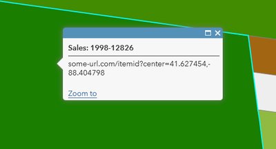

But if it's working in Field Maps, then it may be an issue specific to WAB. Using your same expression, I get this in a web map:

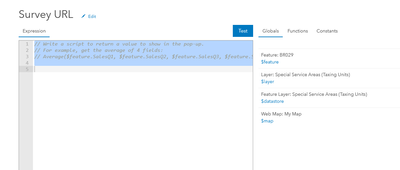

But when I go to open the Attribute Table widget in WAB, it hangs, just as you're experiencing. Interestingly, I see the same issue even in the Map Viewer's attribute table:
I don't think there's anything wrong with your code, but something about the expression and how the table is trying to interpret it. It may be a bug, or perhaps a limitation of some sort. I've tested a few alternate methods, but cannot get the lat/lon values to populate the table.
