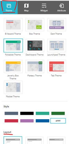

2. In the Web Mapping App, it is not possible to define the size of the widget windows when they open.  For example, the Edit Widget takes up a large portion of the screen (on computers and mobile devices) and it covers up much of the map.
Have you explored the different Themes and Layouts available? Perhaps one of them would suit better?
Otherwise, check out ArcGIS Experience Builder (the latest app builder) which allows you to build your own layouts and also position and customize widget placement. Please note that some of the widgets you require may not be available yet as full functionality parity with Web AppBuilder has not yet been met.

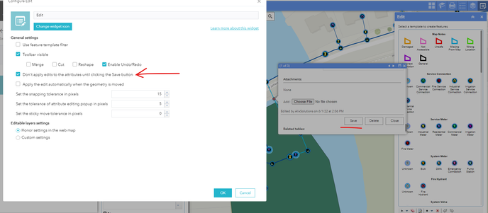

4. In the Edit Widget, there is no clear Save button, even if I choose the option "Don't apply edits to the attributes until clicking the Save button".  The only way to save is to click the very small X at the top right.  This is not intuitive.
The Save button in the Edit widget only controls saving the attribute changes, not the creation of new features. It’s meant to allow for quick creation without having to hit save every time.
When editing attributes for a feature using the Edit widget, a Save button is displayed at the bottom of the window.
On the other hand, when a new feature is created it is created and saved automatically without having to click a Save button.
If this is not the behavior you are looking for, the Smart Editor widget will display a Save button both when creating and updating features unless you opt in to save new features and attributes changes automatically (see the General settings for that widget).
