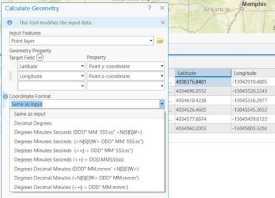

Option 1: ArcGIS Pro - You could access your service in ArcGIS Pro and run the Calculate Geometry geoprocessing tool against the coordinate fields you need to populate. In the tool, you will get some coordinates format options. If you don't want to overwrite existing attributes, make sure to select the features where the attribute is Null before running the tool. Be careful, this will edit your service data directly.

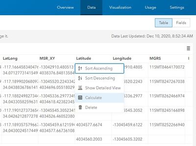

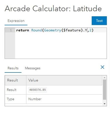

Option 2: ArcGIS Online - Access the item details page for the feature layer you've published and go to the Data tab. In the table, click the field column you need to update and select Calculate. Choose Arcade - if you have Sync enabled on that layer, you won't be able to choose Arcade.

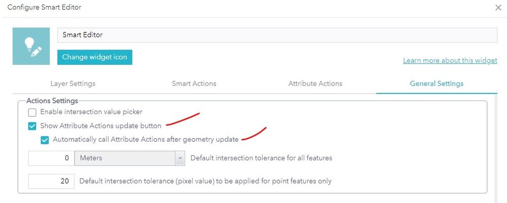

Option 3: Smart Editor widget in Web AppBuilder - This option would be in the hands of your end-user and more in line with what you described as "the engineer could just click a button to fill the coordinate fields".
In the widget configuration, make sure you've configured a Coordinate Attribute Action against the field you need to populate with coordinate attributes. Then, in the General Settings, enable the option "Show Attribute Actions update button". If you need the coordinate attributes to also update when the feature geometry is updated, also enable " Automatically call Attribute Actions after geometry update".

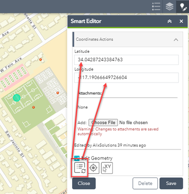

Make sure the Smart Editor is set to open when the app loads (one less click for them, I would suggest). When the engineer will click an existing feature, if the attributes are missing, they may click the "Update dynamic feature attributes" button as shown below to trigger the Coordinate Attribute action. If " Automatically call Attribute Actions after geometry update" was enabled in the configuration, they could also simply move the point slightly to get the values or they would have to double-click the "Update dynamic feature attributes" button.
