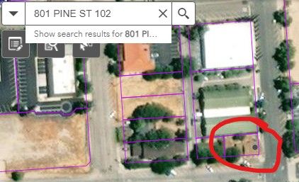

JeffLegato1
Agreed. The highlighted point color needs to be editable. Can you see the dot? Even circled it's hard to distinguish.
