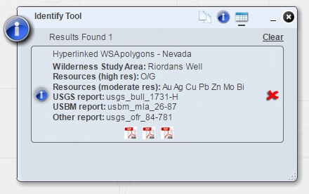

I cannot get custom link icons to be displayed in the ID results.  Only the default icons display.
Although I can access the link icon (attached to this post) via this link:
http://myserver/assets/icons/PDF_icon_15p.jpg
the following xml will not bring up that icon:

Am I doing something wrong?  I also tried popuplinktpe="text" and that doesn't help.

BarnabyRockwell
Deactivated User
Hi Robert,
Got it.  Works perfectly now!
Many thanks!

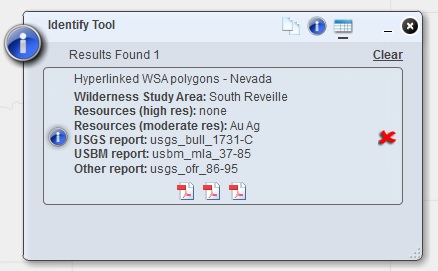

RobertScheitlin__GISP
MVP Emeritus
Barnaby,
  BTW here is a png of the pdf icon so that you don't get the white background.
BarnabyRockwell
Deactivated User
Awesome, thank you very much!!!!!!!!!!!!!!!!!!!!!!!!!!!!!!!!!!
