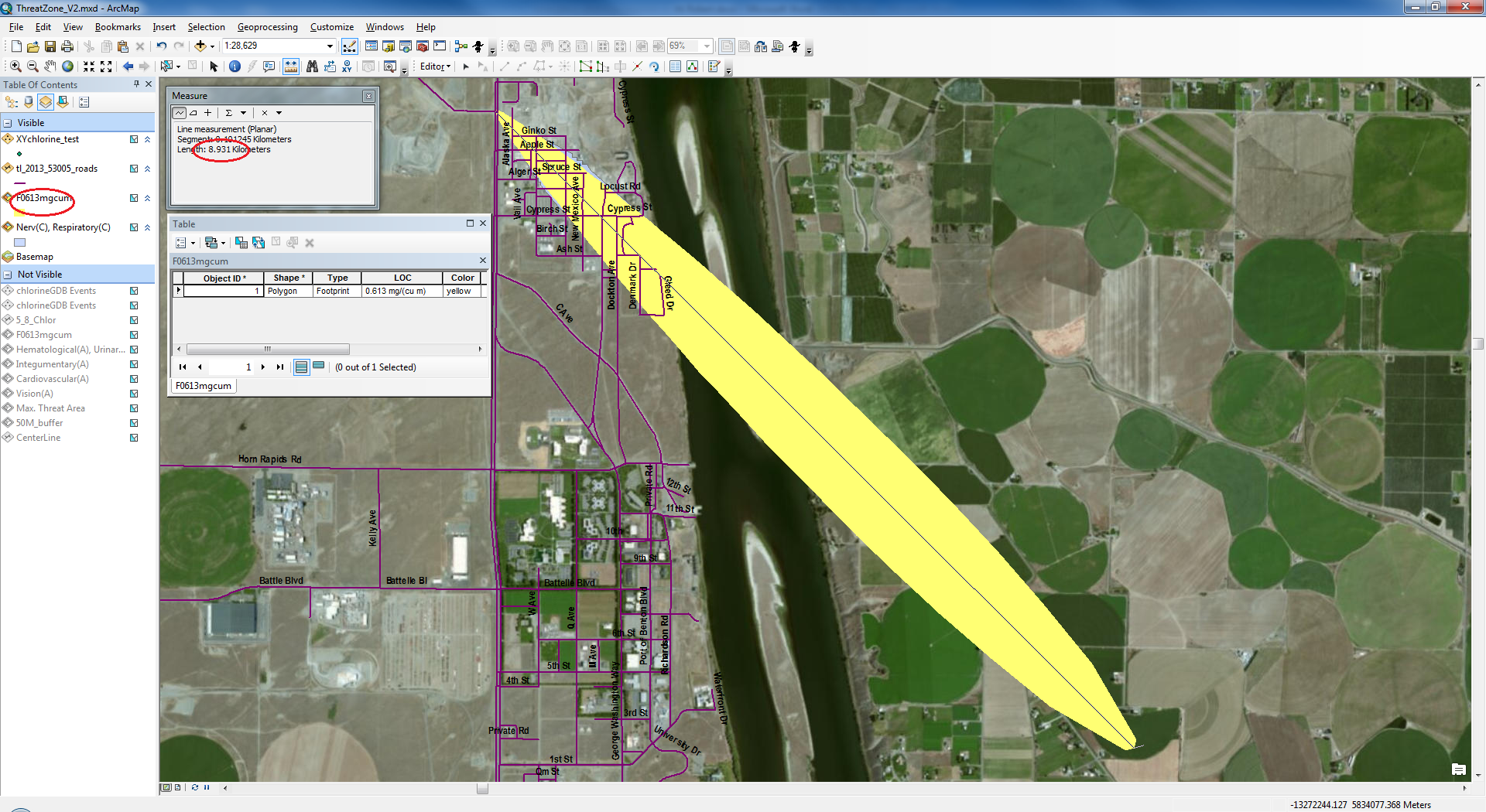

Actually I was using ALOHA for simulating the dispersion of a hypothetical chemical mixture release. I downloaded their ArcMap Import Tools from this link (ArcMap 10.0 version) http://response.restoration.noaa.gov/oil-and-chemical-spills/chemical-spills/resources/aloha-arcmap-... and I successfully imported .pas files to the ArcMap. Howerver, after displaying the plume polygon on the map, I found that the centerline of the polygon is longer than it is supposed to be.

Once this plot is imported into ArcMap, the centerline of the yellow area is 8.8 km (Figure 2) estimated by "measure" tool.
Figure 2. Threat zone displayed in ArcMap

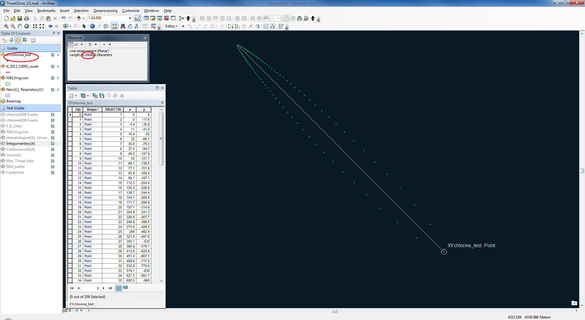

I tried to test if the import tool work correctly or not, so I imported the xy coordinate table of the same plume to ArcMap from excel. It showed the same centerline length as it was in ALOHA (Figure 3) even without projection.
Figure 3. Plume displayed based on xy coordinates
I am wondering if there is anything wrong with this import tool, or because I made any incorrect operation.
