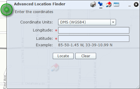

When I was hired part of my hiring meant I adopted some old Flex maps. I've been trying to get WAB versions created but "work."
So... I have one map. It's internal so I can only show screen shots. But our 911 people use it. It has one "custom" widget that I can't find documentation on ANYWHERE. I'm hoping that if I show some screen shots and some of the config.xml for it I can trigger someone to say, "Yeah! I know that one. I can help you!" (and while I'm wishing on a star let's throw in a bucket of money too)
Anyway... here is the XML configuration for it...

and the screenshot for it is here...
If I can find a WAB version of this then I think it might be easier to recreate this map in WAB with this widget. Which is basically all they use this map for, to find a location based on a series of coordinate systems.
Anyone have an idea?

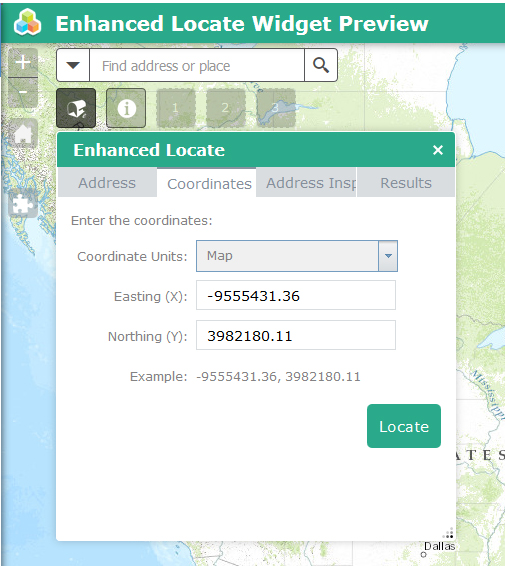

  eLocate fro WAB is now available:
Enhanced Locate Widget Version 1.2 - 10/2/2015
