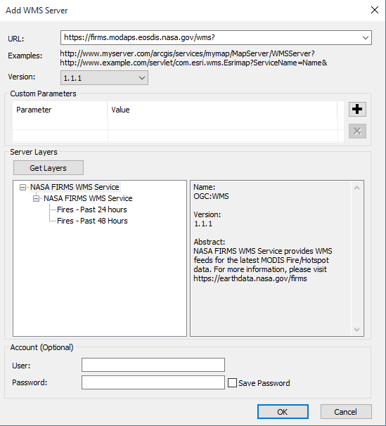

Dear All, would you help me please to add wms in arcgis viewer for flex, the wms link is https://firms.modaps.eosdis.nasa.gov/wms/?

Hello,
Try adding the WMS Server through ArcCatalog > GIS Servers > Add WMS Server.
You could also use this connection URL
https://firms.modaps.eosdis.nasa.gov/wms/c6/?SERVICE=WMS&VERSION=1.1.1&REQUEST=GETCAPABILITIES
Once done, try adding the services from the WMS Server connection to ArcGIS Viewer for Flex.

I've done this action, Sir and succeed proceed input to operational layers. But in the preview the hotspot data from NASA can't shown. Its like the WMS link have a different projection. For your information the WMS link has EPSG 4326 Projection.
