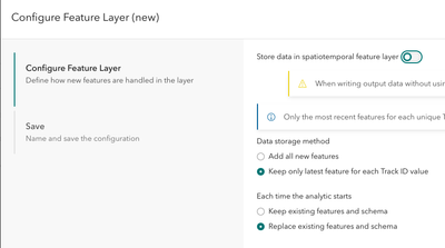

I'm probably missing something obvious here but I don't see how to get that option. The closest I can get is
Each time the analytic startsReplace existing features and schema
When I'm setting up an output these are the options I see

I misread your post Jeff. I'm doing a real time analytic, not a Big Data one. That is why I don't see the option to replace all features every time the analytic runs.

Again, the option I highlighted is for Big Data Analytics, I think you are looking at Real Time Analytics.
Since you said "from the latest run of the analytic", I, maybe wrongly, assumed you were running a BDA on a schedule, once every thirty minutes or some interval.
