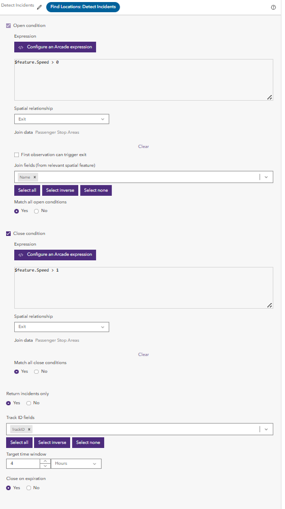

The lack of a geotagger is really causing a problem for me. The issue I am having with Velocity is the join keeps logging points every 10 seconds(source refresh rate) despite the join criteria being set to 'enter'. It keeps logging points even though the train never 'exited' the geofence. I need it to log one point for entering and one for exiting just like Geoevent does. I tried using 'incident' detection but I can't get that to log anything at all using the same logic, but on a stop even the 'closing' event is enters and speed == 0.

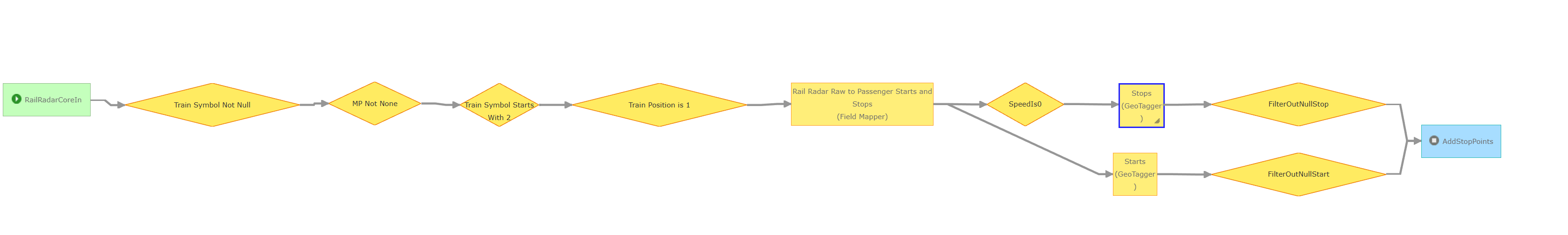

Here is what I am trying to replicate. The Geotaggers are using 'enter any' and 'exit any' respectively. They correctly only generate one point a piece. The filters you see on the geoevent process after the feed are combined into one filter in the velocity process after the feed.

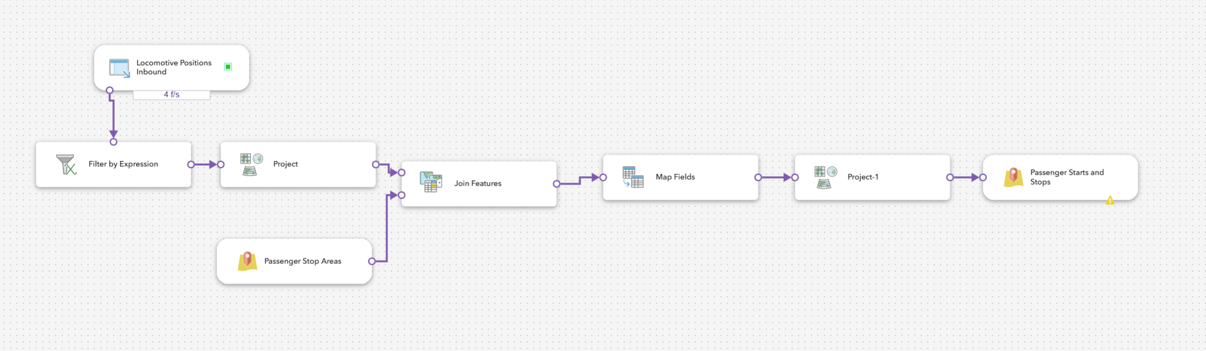

Here is what I have for just stops:

But your geoEvent RTA and your Velocity RTA do not look even vaguely similar in the limit flow picture you were able to cut and paste-
Route by Expression and Split by Attributes may help, and if you just want to find the start and End of a condition, then look at the Incident detect module.
Not sure why you think you need to project the nodes in your new flow.

They clearly aren't working the same way for me. This Velocity feed is only showing the stops line(top row and before) on the Geoevent feed. I removed the 'starts' portion since Velocity can't seem to handle one of these operations, much less two. I am trying to fix one and then the other.
The first 'filter by expression' in the Velocity feed combines the first 4 operations after the input in the Geoevent feed. The speed is 0 filter on the geoevent feed is rolled into the Join as a condition. As far as the projects go, Velocity refused to run if I didn't add them since the Real Time input is WKT 4326 and the geofence layer is WKT 102392, then the output points are WKT 4326 so I have to transform them back.

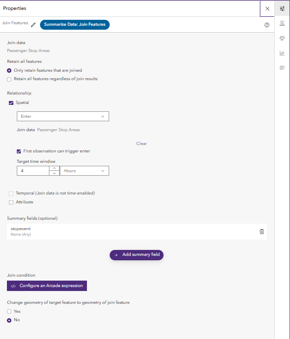

  Can you post/screen capture the Join Details?
  https://doc.arcgis.com/en/velocity/analyze/join-features.htm
  • Checking First observation can trigger enter or First observation can trigger exit indicates that the first target feature received satisfies the filter condition if it is inside (in the case of enter) or outside (in the case of exit) any join feature, despite having no previous target feature to compare the active target feature's location to. The default is false (not checked).
  • Target Time Window?

Yes, one is a locomotive number, and the other one is the station name. I did try a Detect Incidents configuration for both stops and starts. I couldn't get anything to generate at all from that.
Here is the join on the stops currently:
The starts has never generated any events using either a join or detect incidents analytic. The stops version of it was similar, and never generated anything either. I also tried not having a 'close' condition on either one. The speed logic was of course different between the stops and starts as well.

I would make two changes to the Detect ===
Using the Sample data tool, what are you seeing output from the Detect?
Are you sure the Passenger Stop Areas has good data?
Maybe try the join but pass all the data instead of just the matches.
