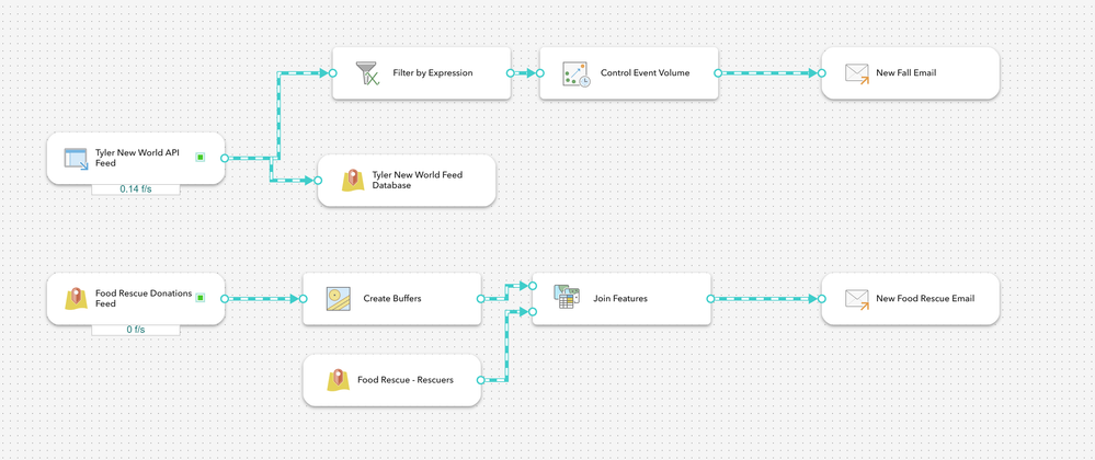

I've got these two RTAs right now, first is sending just me an email when new incidents appear in the last 5 minutes. The second is a dynamic email that is sending an email to the email attribute from all the points that were queried from a specific buffer of a another point (donation location).
Would I essentially be moving these flows completely over to power automate or just pushing the results before the email to a table or something and power automate would watch that??
