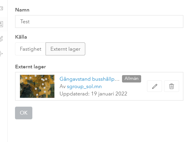

Hi!
I'm trying to use an external polygon layer for my suitability analysis but it's not letting me use certain layers, and I don't understand how it differs from the layers that are working.
AGOL link
The OK button is greyed out so I can't continue.
Thanks in advance!
Till_Schmid
It seems that ArcGIS Urban doesn't like it, that the layerID of your layer is not 0, but 10. You can check this by looking at the service URL: https://services1.arcgis.com/9emqO8hwSgIf8hV8/arcgis/rest/services/G%C3%A5ngavstand_bussh%C3%A5llpla...
As a short term solution, I propose to publish the feature layer again and making sure, that the layerID is set to 0. We will investigate, how we can fix this in ArcGIS Urban directly.
Let me know if this helps.
Thanks, Till

Till_Schmid
Thanks, Till
