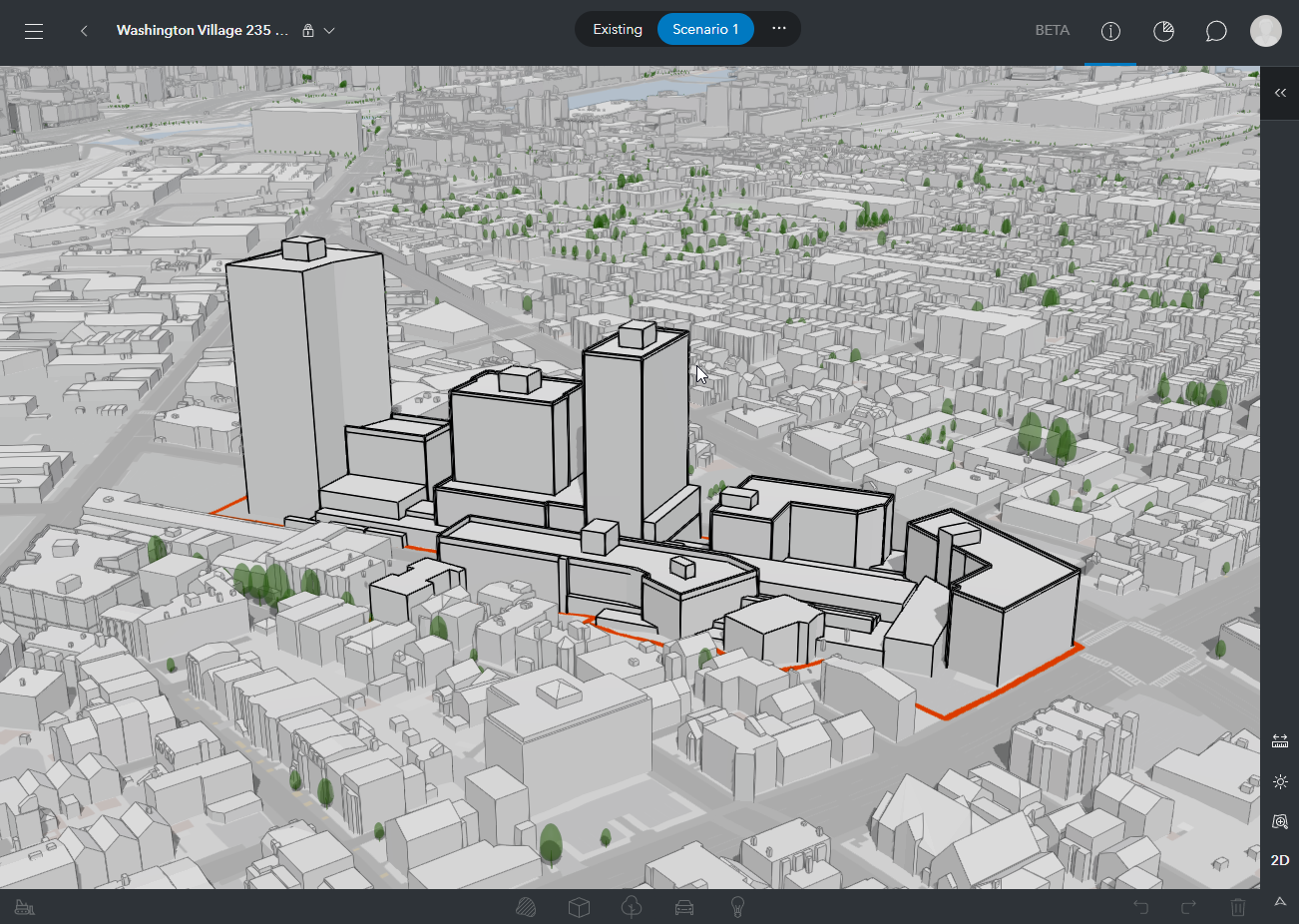

Also, is there a documentation about the query strings. I know the ui=embed-min can load urban in a compact way. Is there other options? For instance I am looking for a way to load urban in an iframe with the right panel collapsed  but with all the analysis tools available like in the image below.

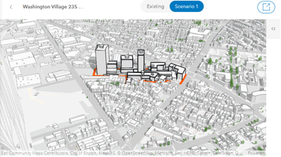

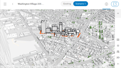

  • Embed: Shows all UI elements, including the analysis tools:
  • Embed-min: Hides the analysis tools:
