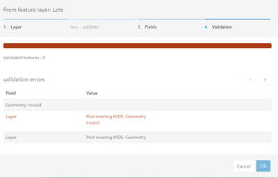

GustavoHenriqueDeOliveiraSouza
I'm trying to import shapefiles as a parcel reference and it goes for invalid features. It's a polyline shapefile made in qgis.
AndreasHall
Not 100 % sure but I would think that your parcels need to be polygons for Urban to be able to import them, not polylines.
