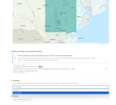

I had started this course yesterday. When I try to import the Hardeeville FGDB, I get two errors.
First error has to do with the coordinate system:
The second error is 'Cannot initialize Urban Model':
Any idea how I can override this error?
Robert_LeClair
Esri Esteemed Contributor
This error with the fGDB has been corrected as of 2/16/24.  Please try the tutorial again and let me know if it works or not.  Thank you!

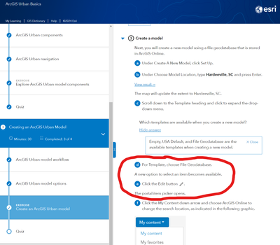

NormWright
I'm attempting to complete the Hardeeville exercise and "File Geodatabase" is not available as an option in the dropdown. Is this specific tutorial outdated? Is the File Geodatabase option removed from the software?
Robert_LeClair
@NormWright - yes, with the February 2024 ArcGIS Urban release, the workflow to create an Urban model based on the file geodatabase and exporting to a file geodatabase was deprecated/retired from the user interface.  The Content Team that authored this web course is aware and is currently working on an updated version of this web course.  Sorry for the inconvenience that this deprecation is causing you in completing the web course.
