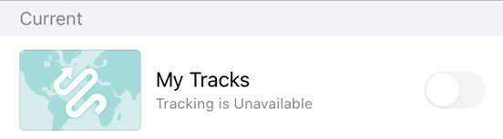

Hello--I am new to Tracker and am trying to set it up. However, I am getting "Tracker is unavailable" in Field Maps.

However, when I go into Field Maps, I get this:
I am sure I am missing something really ridiculously easy, but here I am. Any guidance would be great. I am trying to setup a Field Map for a colleague and tracking is going to be an essential part of this.

by Anonymous User
Not applicable
You might have to sign out and sign back in in order for Field Maps to find the location tracking feature service. When it can't find the service, you see the message in your screenshots.

You know, it is really embarrassing when the solution is something so simple that it could appear as a running joke on the IT Crowd. Have you tried turning it off and on!
I actually completely quit the app multiple times, but never signing out and in again.
All that fancy education for nothing!!!
I jest, of course. I like easy solutions and like to laugh at myself. MUCH appreciated. That obviously worked.

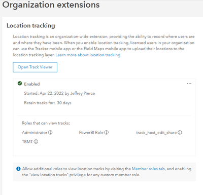

I have been having the same problem here -- as have two of my colleagues. Through my admin account I was able to turn the tracking on and record my tracks but every other account is unable to.
Tracking was turned on at the organization level as seen in the first photo:
The rest of the user accounts receive this message even though they have been added to the track viewer layer and should be able to record their own tracks and see the other tracks.
Any assistance on how we can activate the tracking for all users both so they can track themselves and see the other users tracked fields would be amazing.

LucasBlackmore
The image that all other users receive is the same as the original post saying My Tracks: "Tracking is unavailable". We have tried signing out and back in to Field Maps but the message remains.
by Anonymous User
Not applicable
Check the privileges of the other uses, the location tracking service is shared to the org by default. There is privilege which is required to view content that is shared to the organization. If the user doesn't have this privilege, the location tracking service cannot be loaded.
