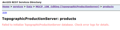

Hello,
Our team recently published a Topographic Production Service for our DEV environment.
However, we encountered this error message when trying to configure the addProduct SOE
I'm wondering if there is any solution for this?

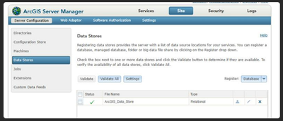

1. Through ArcGIS Server Manager, can you verify the status of your ArcGIS Data Store?

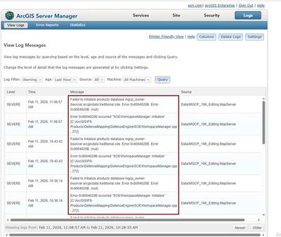

Yes, we have examined the server logs and encountered these 2 error messages.
From the error logs, it looks like the looks the error points to the Esri Inc. internal tools .cpp (C++) compilation issue

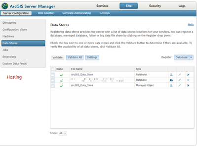

2. Are you using the Postgres database as the Topographic Production Database or for the published MGCP data?
We are using the Postgres database as the Topographic Production Database.
3. You mention the product files being in the hosting server. Can you expand on your server deployment configuration and what software is installed on each machine?
Where do we find the server deployment configuration? Would our Portal Organization page's Servers be enough and its server roles?
