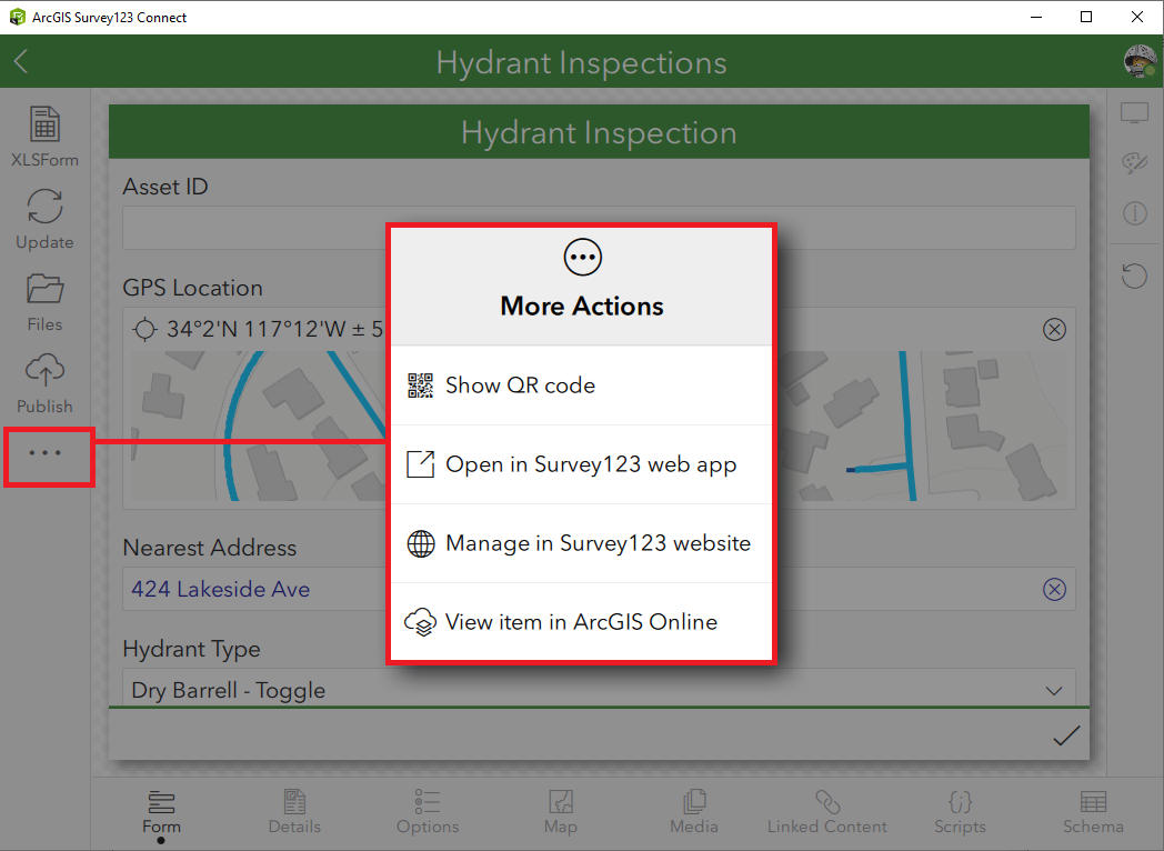

Can I make surveys authored in Connect publicly available? Yes. Publish your survey and then share it publicly using the Survey123 website's collaborate tab. Publish from Connect, manage from the Survey123 website. The screenshot below shows how you can open your Survey123 connect surveys in the Survey123 website.

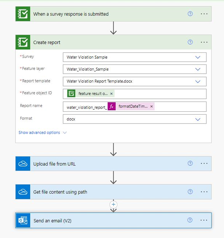

When is the Microsoft Power Automate Survey123 connector going to include the Create report action? We are aiming at having a preview for Early Adopters in January and a General release shortly after, in February 2023.  Stay tuned as we will be announcing availability in the Esri Community ArcGIS Survey123 blog and Survey123 Early Adopter website
Do I need a Premium Microsoft license to use the Create report action? What about downloading the reports? Do I need to use the Premium HTTP module? No. The Create report action will be part of the existing Survey123 connector. Microsoft Power Automate includes options that allow you to bring your Survey123 PDF reports into OneDrive without a Premium license, as shown in the screenshot below.
