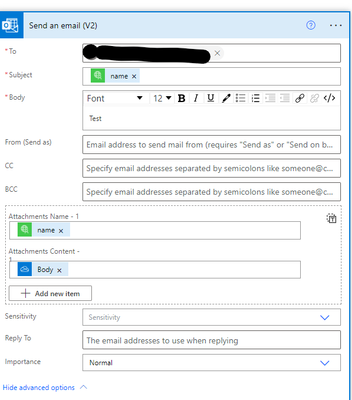

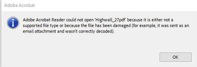

For your first demo, I followed everything you had mentioned.  The pdf uploads to my one drive and opens perfectly from there, however when I try to open the attachment in the email. I get this error.  Any ideas?
phess_luckstone
Just in case anyone follows this post and gets the same error as mine, I had to change the attachment content to body. This has fixed the broken/empty attachment in the email.

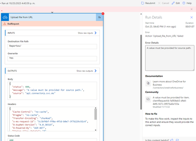

Lucas_Halphen
Hello.  I followed the steps as indicated on the video.  But the process stops at the 3rd step.  There is an error, it seems that the source URL is not found. Do I need to request our IT dept. to allow connection with OneDrive, Pwr Auto and S123?
The S123 that I am using has a template and a webhook.
Another question: ¿ I wonder how you put a long string of ${variable_name] into such small table boxes without expanding (or keeping the column size as needed)?

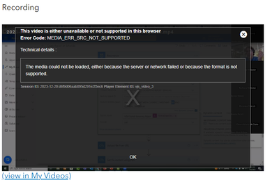

MichelleWong58
I am trying to access the demo video but it is indicating that something is wrong. Is there a youtube link somewhere?
