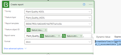

@IsmaelChivite I have created several flows that generate reports in Power Automate, then save them on One Drive, and then email them to the person that submitted the survey.
In the "Create Report" section, I am giving the report a unique name using fields from the survey. I want to add the date to the name as well, but am struggling to get the formatting right. I know that I have to use the formatDateTime() expression, but I am just not able to get the syntax correct. My date filed in my survey is called q1_3_assessmentdate. I have tried using the following but it isn't working:
formatDateTime(triggerOutputs()?['body/feature/attributes/q1_3_assessmentdate'];DDMMYYYY)
Previously, in Integromat, I used to format it like below:
Please could someone explain to me how i format the date properly. I am not interested in the time at all, just the date
Thanks so much

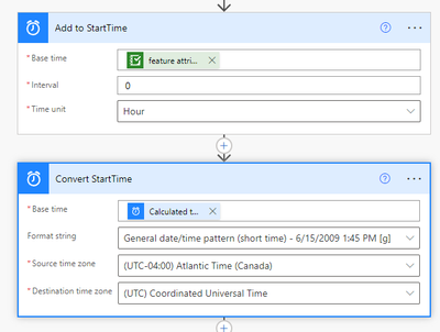

If you're looking to use a dateTime field from your data you may need to include the add and convert time functions in the flow as it's stored in Epoch time, though I can't remember for the "date" type itself.
Otherwise, if having the date that the webhook is triggered works you could always just used the timestamp function in Automate. I have the function as
formatDateTime(utcNow(),'D')
With 'D' being the date format like Thursday, March 23, 2023. Some reference here: https://learn.microsoft.com/en-us/azure/logic-apps/workflow-definition-language-functions-reference#...

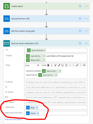

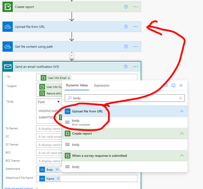

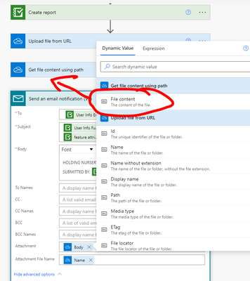

This is a great solution, thank you so much. My .pdf report is not coming through fully to my MS Teams/sharepoint folder though. It appears to work since it posts a .pdf file there and names it as I designated, but it cannot open and is only 3kb. Any ideas what I've done wrong?
Paulvan_Heerden1
Hi Ben
I ran into this as well. You are just selecting the wrong Dynamic value in the Attachment field. You have to specify the attachment (which is the actual content of the file that you are missing), as well as the Attachment file name. This is the one that you have correct because it saves a pdf with the correct name. You just don't have the contents correctly specified. Thus it gives an empty file
In mine, I chose the Body from the Upload file from URL section. I think you can also use File Content from the Get file Content section
Just play around and see which works for you. I am sure you will come right
