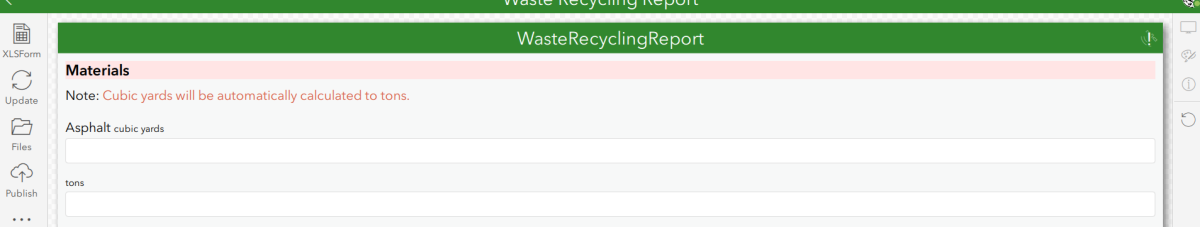

XLSX form showing calculation:

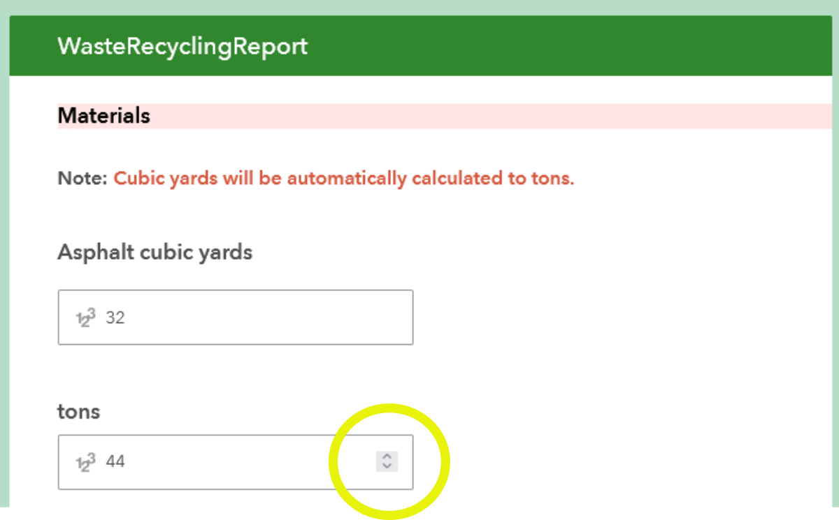

Same elements after publishing to web app. I circled the increase/decrease arrows in yellow:

Interesting that it's applying the "spinner" appearance without you specifying that.
Will users ever be adjusting tons without entering cubic yards? Will you be keeping both fields, or just using the calculation to get all the values into "tons"?
A possible option is to set the tons question to "text" (but leaving the bind::esri:fieldType as  esriFieldTypeInteger). Optionally, set the tons field to being read-only, if you don't intend on users changing its value, but simply defer to the calculation.

(1) The user should be able to enter a value for both cubic yards or tons.
(2) If the user enters a value in cubic yards it should be automatically calculated to tons.
(3) I don't want the user to be able to adjust the tons value.
I tried your first suggestion. I changed the type to text and set bind::esri:fieldType as esriFieldTypeInteger. Then I republished. No difference. The "spinner" is still there.

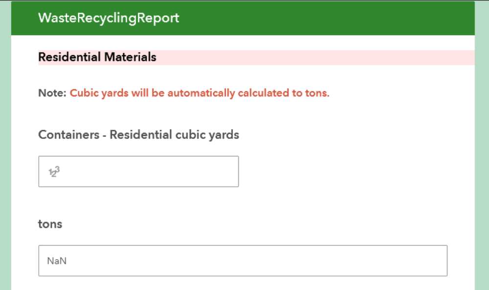

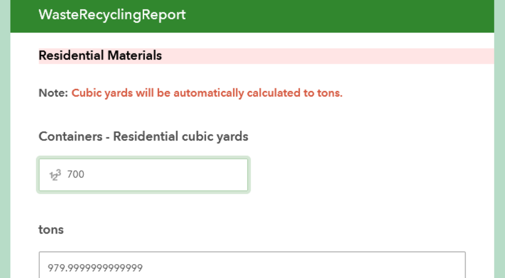

To update my reply to @jcarlson's answer: I mistakenly looked at the wrong page of my survey. You might have the solution. There is no spinner, but I get a NaN in the tons box. That's better than a spinner, anyway.
And now it's suddenly giving me multiple decimal places when before it was giving none. I'll have to look into that.
