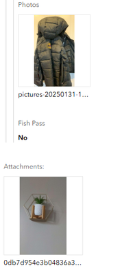

QuickCapture and Survey123 both share the same FeatureLayer but photos are placed under "Attachments" for the former and "Photos" for S123.
So I can't see the photo attachments taken in QuickCapture in the survey when opened via the inbox in S123.

The "photo" question in S123 is of type image.
When I view a completed survey the images that were taken using QC appear as "attachments".
Any images taken via S123 appear in the Inbox.
Is there a way to configure QC to use "image" instead of "attachments"?

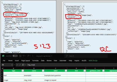

As suspected, images taken/attached in Quick Capture are missing the keyword that looks like it should be the Survey123 image type question name (confirmed here in Survey123 Connect docs).  Here are is a photo of the problem and the potential solutions.
(repeat from above, didn't work for me with Enterprise 11.3) - HOW TO: Update attachment keywords for existing images in Survey123 data from REST
Looks more promising, but I don't have time test.  Update attachment keywords using the ArcGIS API for Python
