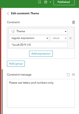

In the Survey123 Web Designer constraints I want my string field to only include letters, numbers, and spaces. My understanding is that the regex would be: regex(.,'^[a-zA-Z0-9 ]+$')... however this fails to publish.
I'm entering this in the UI in Web Designer
^[a-zA-Z0-9 ]+$
I've tried many many different things and it seems like the fail happens because of how $ is being handled as is passes ^[a-zA-Z0-9 ]+$ from the UI to syntax. Excluding $ does not solve the issue - it publishes but passes the constraint no matter what is entered in the string.
Publishing seems to be taking what should be regex(.,'^[a-zA-Z0-9 ]+$') and turning it into regex(.,'^[a-zA-Z0-9 ]+)) and failing to publish.
works in the opposite way... like the constraint would only pass if my string includes a special character. So don't want that.

ERROR WHEN PUBLISHING:
  • 999: b"ODK Validate Errors:\n>> XForm is invalid. See above for the errors.\norg.javarosa.xform.parse.XFormParseException: bind for ${Theme} contains invalid constraint expression [regex(.,'^[a-zA-Z0-9 ]+))] Couldn't understand the expression starting at this point: regex(.,\xcd\x8e'^[a-zA-Z0-9 ]+...\n\nResult: Invalid"
