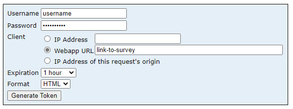

Hi @PaulSweeney3 , thanks for getting back to me. In the most simple application I would like to be able to use tokens generated from https://<host>:<port>/arcgis/sharing/rest/generateToken?, specifying  the survey URL as the client as shown in the picture below, and manually append them to survey links before sharing them with survey respondents. Thanks for your help!
