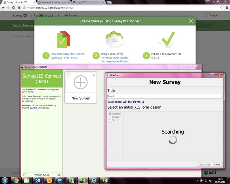

Greetings all,
I'm trying to use Survey123 Connect for the first time.  When I click on New Survey, I get the New Survey form, but nothing else happens.  Searching just spins incessantly as shown below
I am using Windows 7 and Excel 2007.  Any help to get this going will be greatly appreciated.
Miguel

Excel 2007 is not likely to be the problem here - you can use any spreadsheet application that can open and save .xlsx (or even .xls) files. Some examples are Open Office and Libre Office. We have had some success with Numbers (from Apple) but you do need to purposefully save the file as .xls or Export as .xlsx.
Regarding the hanging, that is more likely to do with your connection to the internet. Do you have firewalls or proxy's perhaps?

Many thanks for the response. I have checked with a colleague from Esri UK, and she has been able to run Survey123 Connect with Excel 2007 at a customer site.  Since what seems to be happening, as I am able to tell from the screen capture posted, is that Connect is attempting to contact a server, to retrieve information on the Templates and Samples. Is it possible that blocked communication to said server could be making Connect hang, and not necessarily Excel 2007?

Many thanks for the response.  That is exactly what I wanted to know.  I think you are also correct about the connection problem. I can replicate the behaviour myself by turning off the internet connection on my laptop and then attempting to create a new Survey.  It just seats there, hanged, with the spinning searching message.
I have gone back to the person who is having the issue and suggested to check with their IT if there is anything that could be blocking their access to external servers.
