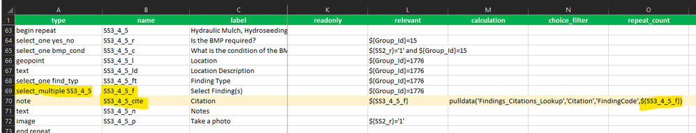

However, I cannot seem to get the question to display any text! When I change my first question type to select_one it works just fine. Am I missing something in my syntax? I've included screenshots below if that helps.
pulldata('Findings_Citations_Lookup','Citation','FindingCode',${SS2_f})

I believe my request is actually the opposite. I want to use a select_multiple to populate a text field using the pulldata() function. Does that make sense? I've attached a screenshot of the relevant section in my xls form for more context.
