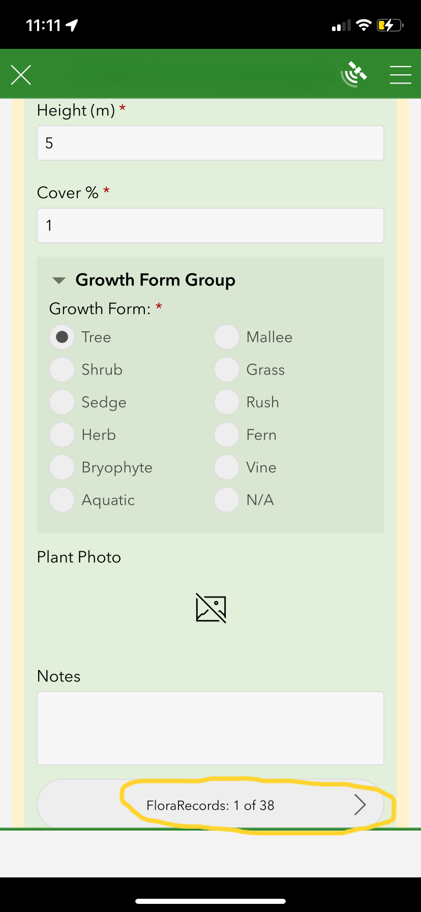

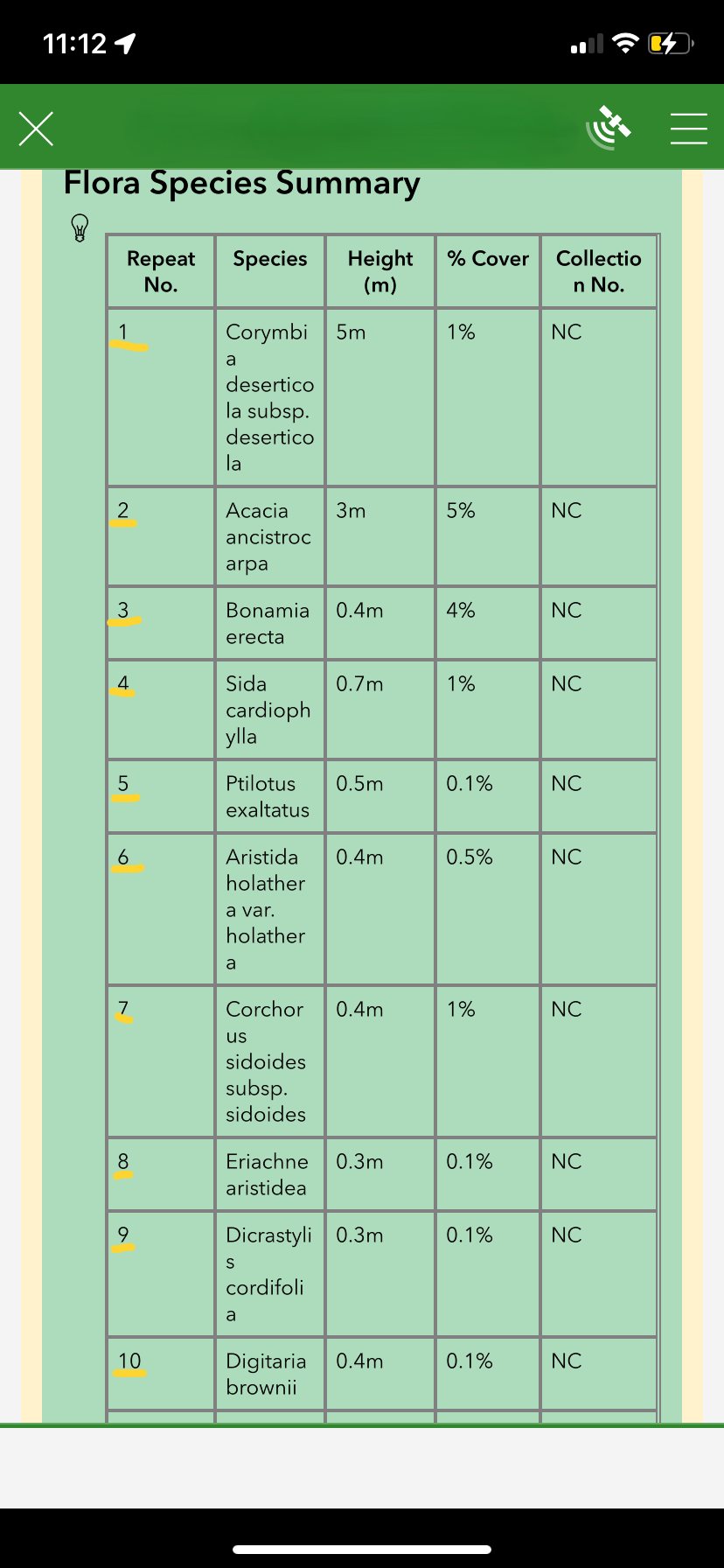

I found this old post from 2021 regarding a link to navigate to records in a repeat in the Survey 123 Field app and wanted to check in there has been any updates since?
https://community.esri.com/t5/arcgis-survey123-questions/use-a-link-to-navigate-to-a-record-in-a-rep...
Our field team conduct flora surveys and can sometimes collect into the hundreds of records for one quadrat, and on occasion need to go back into a record to update values.  Pressing the next arrow many times is quite time-consuming and we would like to be able to make this process more efficient by adding a link to the record in the table to navigate to the record. Have any updates been made to make this function available?
