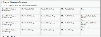

I do summary pages for the crews so they can see any weird values at a glance.
I even give warning messages in red
But no you cannot edit right there since that would be having one field in two places.  They still have to go find the issue.

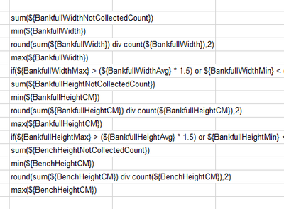

Nice! Do you use Javascript code to generate those summary pages? I'm assuming you're pulling information from the repeats to build the summary?  If so, I'd love to see a snippet of your code.  Thanks very much for your guidance!
DougBrowning
MVP Esteemed Contributor
I just use min, max, sum, and join.
