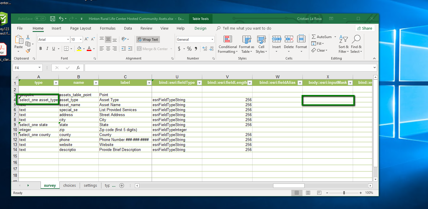

Hello,

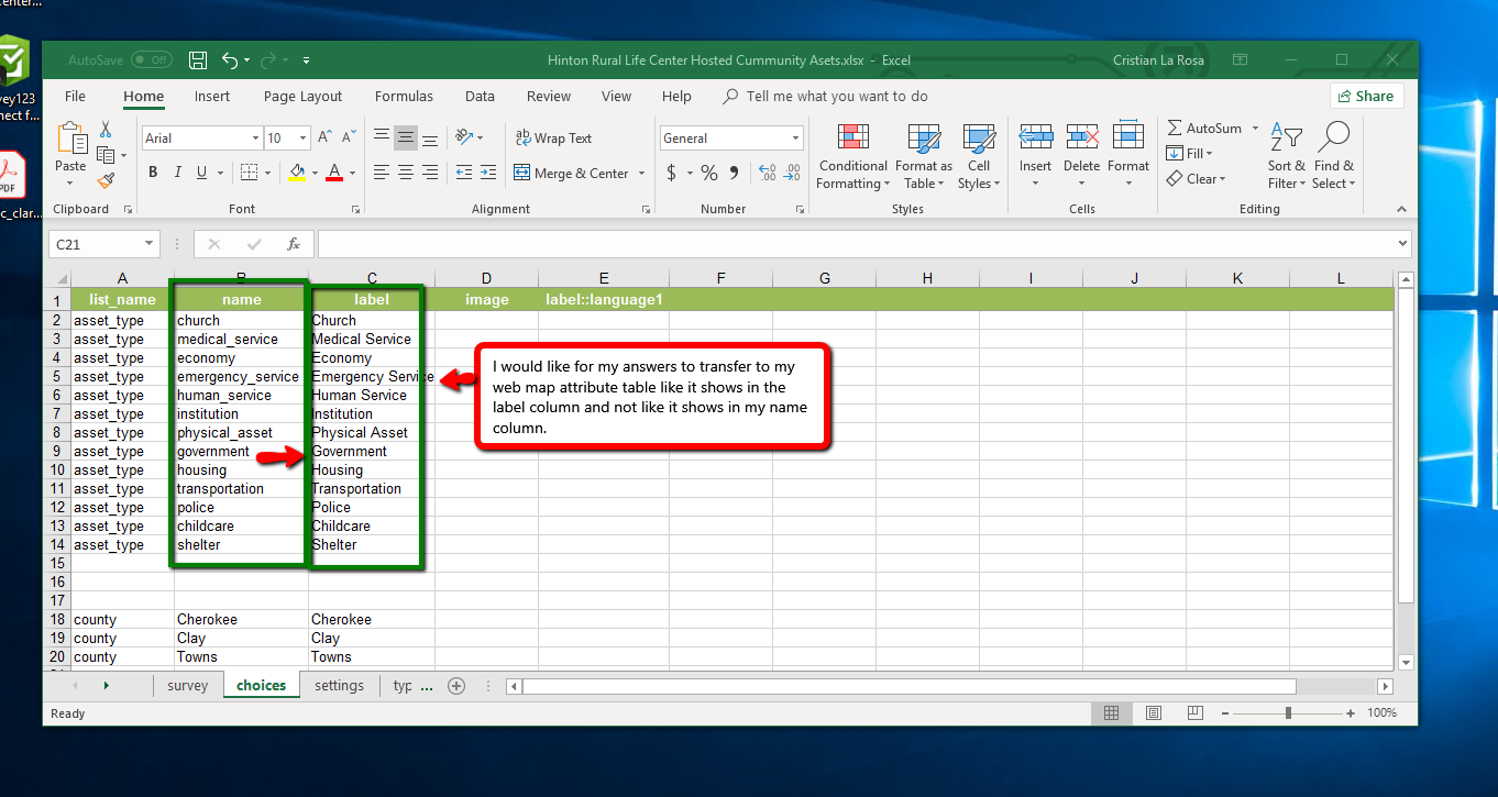

   I am trying to match my survey answer using the body::esri:inputMask custom column using the Select One question format. I would like for my answers to match previous answers in my web map attribute table. For examp: "Emergency Service" instead of "emergency_service" using the Select_One question type. I am very new using survey123. I was looking at the examples in:
Esri custom columns—Survey123 for ArcGIS | ArcGIS
But I am still very confused.
Thank you for your help.
Cristian

Hi Cristian,
Did you solve your problem, the value being stored in the feature service is the value in the name column, labels are then displayed in the app, survey123 website, AGO and you can configure the labels to be displayed in a web map.
Phil.
