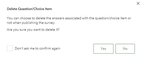

Then the old questions were deleted by previously identifying their number within the entire survey ensuring the new questions were not accidentally deleted.  A popup (Shown Below) wanted a confirmation of the deletion and then stated any previously captured data could be deleted or not during the publishing phase.  I clicked 'Yes' and did not check the 'Don't ask me to confirm again' box, because I always like a safety measure in place to stop potential accidental changes.
Deletion Confirmation

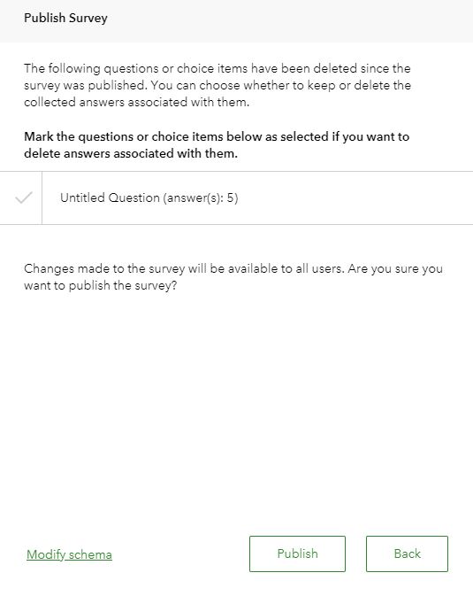

Once the new questions were in place, the old ones deleted, and the survey saved, I clicked the 'Publish' link and then clicked the 'Modify schema' link.  The schema for the survey now allowed me to modify the 'Field Length' for the new questions.  I then clicked on the 'Publish' link.
A popup appeared asking me if I wanted to keep or delete the previous answers for the old questions.  If I wanted to delete all previous answers for each question than I could have marked each individual question, but I just kept the fields unmarked and clicked the 'Publish' link.
Keep or Delete previous answers
