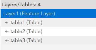

On the second issue of data not submitting to the related table I don't believe I'm reproducing what I interpret as the scenario. I have a hosted feature layer with a parent layer and 3 related tables and when I create my survey based on that hosted feature layer the schema I see in Connect is:

Which I believe is equivalent to your image 2. I removed table1 and table3 from my form design only leaving table2 and published the survey:
When I submit a record in the Survey123 web app I do see the related records come through in table2
