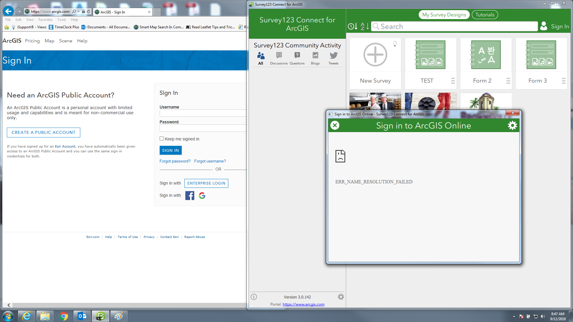

Survey123 ver. 3.0.142. Attempting to log into ArcGIS online not an enterprise portal. Error shows "ERR_NAME_RESOLUTION_FAILED"

A screenshot would help confirm, but it sounds like the device is not able to access ArcGIS Online.  Can you confirm that cellular/wifi access is enabled for the Survey123 app, and that you can reach https://www.arcgis.com through a browser?

Here is a screenshot of the log in screen. I just updated Survey123 connect.

Hi Alvaro,
Thank you for the screenshot.  Can I ask you to create Open Survey123 fresh, click on the gear icon, select Diagnostics, turn on logging, and then attempt to login (and afterwards share the log file with me - jtedrick AT Esri.com )?  Also, is this computer configured by an IT department that might have set a limit of which programs can access the internet?

It was not a firewall or management issue, I could connect on another machine. I uninstalled and changed the installation folder to the local c: drive not in the user folder and it is up and running now.
