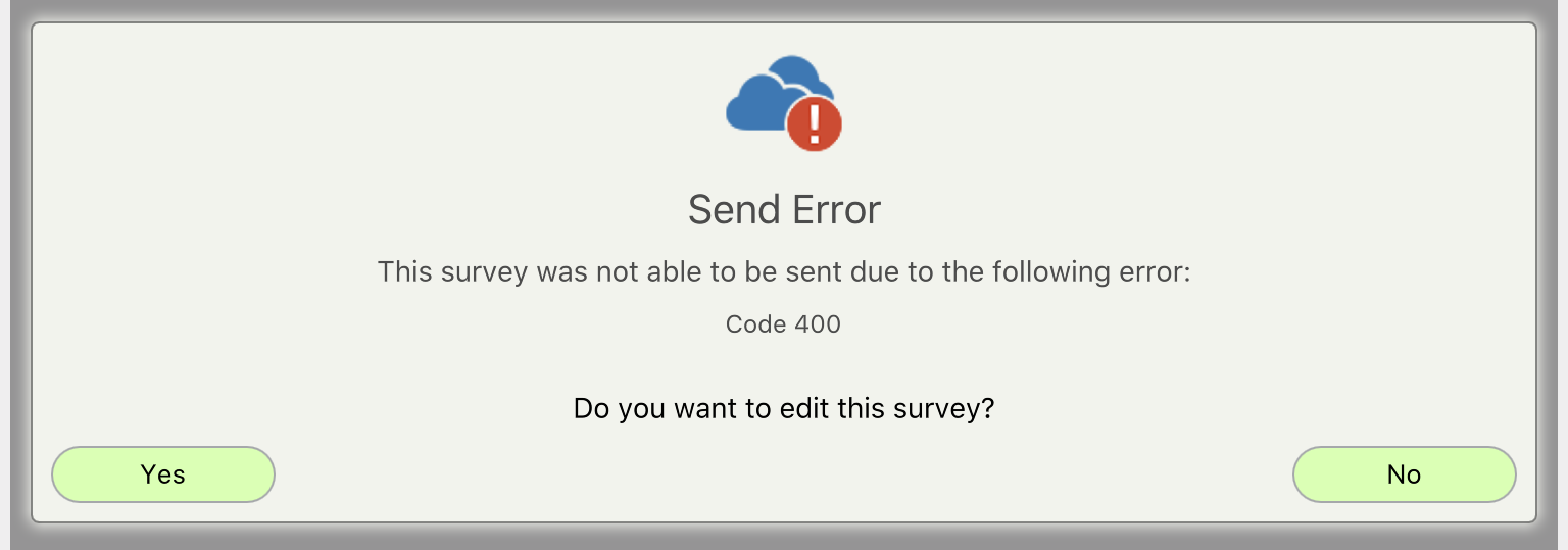

I get an error when trying to submit a survey.  I am pretty sure this has to do with privileges.  When I am logged in as myself (Publisher role), I can submit the survey with no problems.  When I am logged in as our test user (a custom role defined as Field Editor), I cannot submit the survey and receive the following error message:

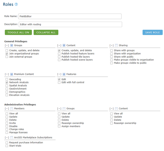

The only difference between myself and the test user is the privileges assigned to us and our test user has the above privileges assigned.  Here is a screen capture of the privileges for our custom Field Editor role:
Am I missing something?  If this isn't an issue with privileges, what else could be causing this problem?  Thanks!

Just to check, the survey has been shared to either a group that the field worker is in or the organization?  I am able to submit data from a similarly restricted role.
CarmelConnolly
Further to James' comment, make sure that both the survey form & the feature service are shared correctly.
Hvae you tried assigning the test user the publisher role to see if that at least works?
JimW
I verified that the survey, feature service and map where all shared to a group.
I tested our test user with permissions switched to publisher and the same issue occurred.
JimW
I think I have this figured out.  As part of my hosted feature services for manholes, I also have a layer for capturing the inspection data data via the submission URL.  Because I didn't want my field workers to be able to make changes to the manhole geometry, I had editing restricted to attribute updates only.  I didn't realize that when the inspection data was submitted that Survey123 was also capturing the location of that survey and adding a point to my inspection layer.  In hind sight I should have realized this sooner as the original layer I created in desktop, prior to uploading to AGOL, was a point feature class.  Anyway, once I updated my edit settings to add, update and delete, I was able to successfully submit the survey!
