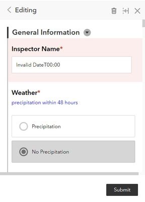

I am trying to make edits (I am an admin) to submitted survey using https://survey123.arcgis.com/ website. But one particular survey every time I select edit, a text field gets overwritten with the below message.

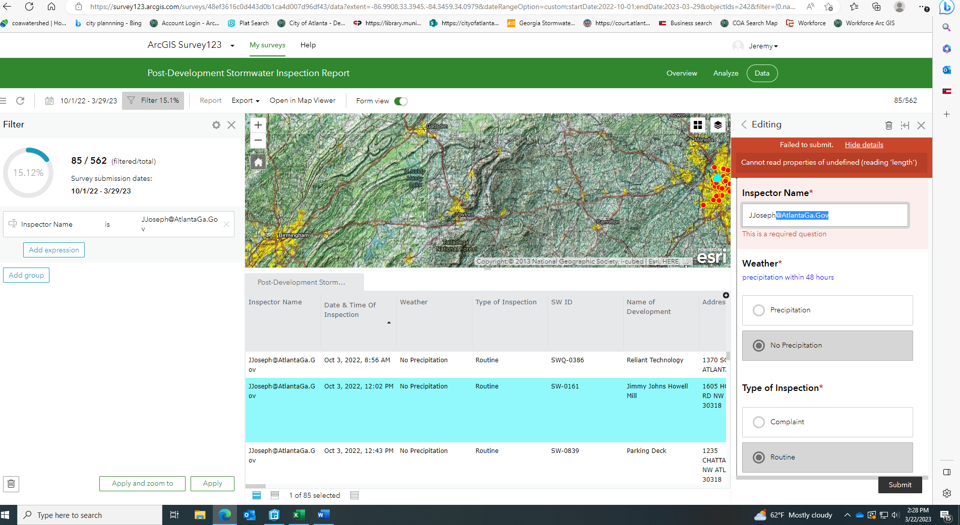

Screenshot 2023-03-29 132637.JPGBut when I go to enter in the email address, I get the below message.
This behavior does not happen to other surveys.

Hey there,
Taking a quick look at the XLSX file, it seems that the calculation value for the Inspector Name question uses an outdated function - property().
Documentation regarding that function can be found below:
FAQ: What happened to the Survey123 property() function?
Try updating the calculation function to pulldata() as opposed to property() and see if that fixes things!
GISManager4
Thanks for the head up. I made the change.
