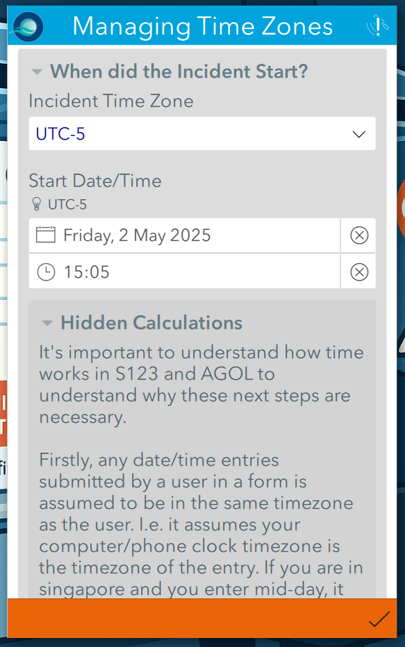

LiamHarringtonMissin_1-1746216324779.pngLiamHarringtonMissin_1-1746216324779.png  LiamHarringtonMissin_2-1746216355046.pngLiamHarringtonMissin_2-1746216355046.png
The form now presents three key time references back to the user:
  1. Incident Time – Entered by the user in the selected timezone
  2. UTC – A calculated version of the incident time shown in UTC
  3. Your Local Time – Based on the device’s timezone
This isn’t just for show. Presenting the relevant different time zones can help users spot obvious errors like entering a future time by mistake or selecting the wrong timezone. It’s a subtle but powerful form of validation, helping avoid confusion later without slowing things down.
