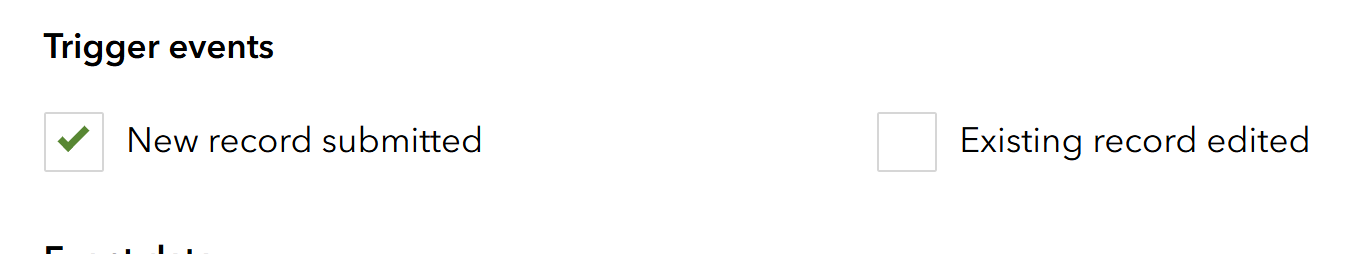

Last weekend 3rd/4th May 2025 a very odd thing happened in that many of our surveys were updated without our doing. The updated times were random for each survey and this resulted in the webhook setting being changed so that the 'Existing record edited' was turned off and an older version of a csv being used for a select from file question.

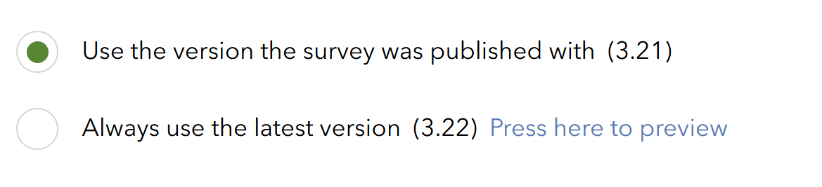

I would appreciate any comments on how we can avoid future occurrences of similar behaviour. I was looking at the below setting but not sure which is best to choose. (However, this may be a totally irrelevant setting??)
