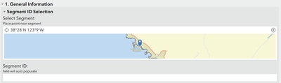

I am trying to get this work after trying to work with json. Where based on a geopoint question it returns a value.
pulldata("@layer", "getValueAt", "attributes.Label", "https://agency_name.maps.arcgis.com/home/item.html?id=5fa01c8e666740968c727b8a81f78ef7&view=service", ${Segment_ID_Point})

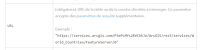

Hi Steve, my guess would be that
- first : you have in fact to use the REST URL of your layer (don't forget the '/0' at the end), like
- second, you have to add a buffer instruction at the end of your URL if you want to capture the label near the point position your users will enter. ("?distance=XXX&units=YOURUNITS"
The help topic might be of help : Formules—ArcGIS Survey123 | Documentation
Have a nice day
