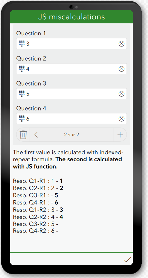

Since latest releases, I’m struggling with a problem in my java script functions.
When a question is left blank in a repeat, in the next repeat, the same question value is shifted from the second to the first repeat.
As you could see in my example, if I left question 3 and 4 blank in my first repeat, the value entered for these questions in the second repeat are attributed to the first when calculated with Java Script…
Any solutions?

I've built a JS function to validate responses in a form by comparing answers from many questions within the same repeat. Example:
If you answer the first question, you must answer questions two and three.
The response will also be used to validate the following questions.
If you do not answer the first question you can skip the others or not.
And this for each repeat in my form. That’s why it is so important to have “undefined” value for unanswered questions.
This was perfectly functional in earlier releases.
Is this a bug?
