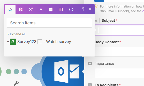

We created a new scenario where Survey123 is watched and when a new record is added, it will send an email to the desired team.  When we click on the subject line or body, we are not given the list of attributes from the survey that I have seen with other surveys.  See the attached image for reference.

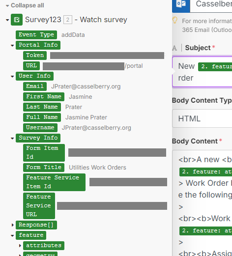

Previously, I created two scenarios in Make that used a survey created by Survey123 Connect.  These surveys used the same existing hosted feature service.  The Outlook fields provided the attributes from the survey and it worked without issue.  See image below.

JasminePrater
Although we have not solved our issue as to why that web version survey is unable to pull the attributes into the email, we were able to get it to work with a copy of it.  I had her save her existing form using Save As and the copy worked.  That makes me wonder if her original form is corrupted in some way that didn't carry over to the copy.  We had the same issue with a few test forms we created in the web version while troubleshooting, so I'm not sure if that was truly the problem.  There were no settings that changed between the original and copy versions, so I'm at a loss.  If I am able to successfully recreate it in the future, I will update this ticket with that information.
