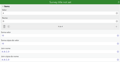

I'd like to report a bug on calculates within repeats of web forms.
The calculate fields from the first inserted item are always
updated accordingly the last modified item, causing wrong
calculation values being sent to the data store.
The same problem doesn't happen with the field app.

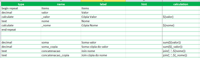

Form:
Behaviour on the web:
Error web formError web form
