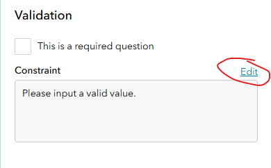

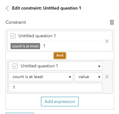

I am having the opposite problem. I want to constrain participants to only be able to choose one option. I found this that says I can: Understanding Multiple-Choice Questions in Survey1... - Esri Community, except I'm not seeing those options underneath the validation option. If it were there though, sounds like it would solve both of our problems.
Neal_t_k
MVP Regular Contributor
@BoardsSupport For a multi-select add these two constraints.
