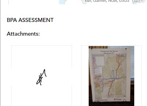

When viewing submitted surveys in the Suvery123 Web app, the Individual Response and Print Current Response does Web app view
not show the data in the sub-groups of the XLS form created in Survey123 Connect for ArcGIS.

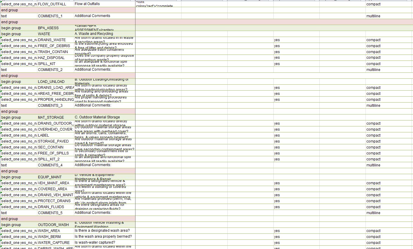

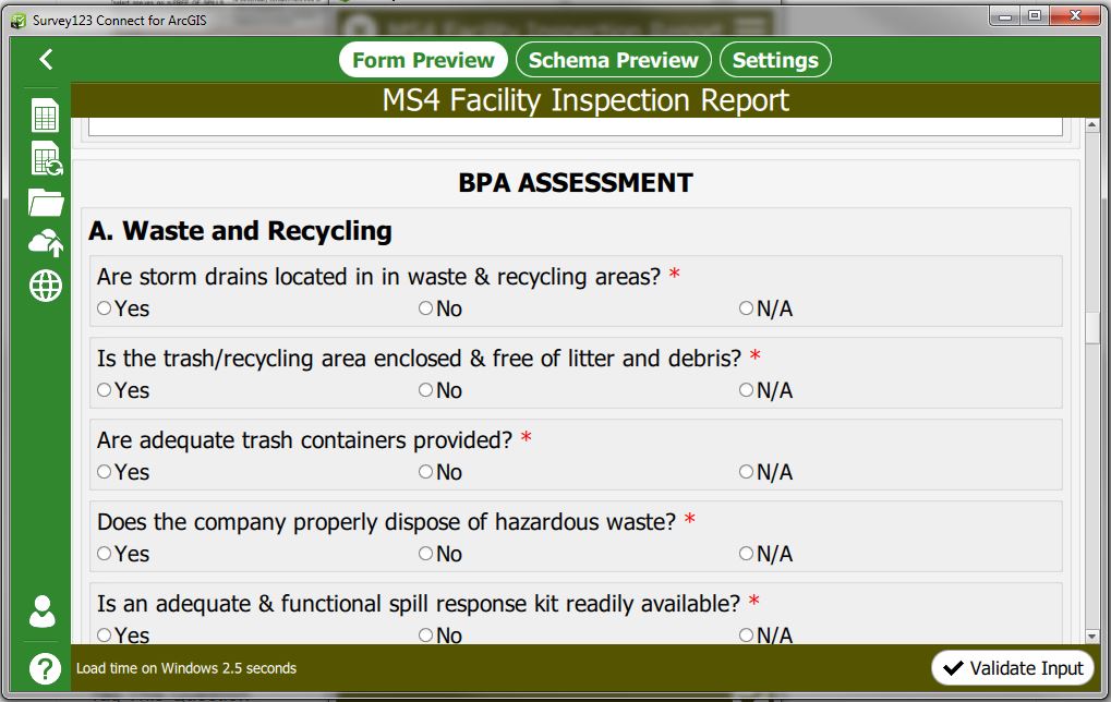

Survey123 Connect for ArcGIS XLSform
As you can see for the Form Preview I have a BPA Assessment group and sub-groups for each category of questions.
The fields show when viewing on AGOL. IS there are an issue with having multiple groups in Connect and them showing in the web app?

Hi Carl,
This is a known limitation of the Survey123 website at this time.

Just want to let you know that it has been fixed in individual response in 2.4 release now. For the Analyze page, nested repeats/groups will be supported in 2.5 release.
