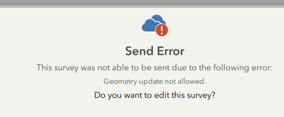

Hi, We are unable to upload completed surveys into our portal environment. getting the error "Geometry update not allowed". see image. Any help is greatly appreciated

Try editing your feature service and check the 'allow geometry updates without m-value' check box.
https://enterprise.arcgis.com/en/server/latest/publish-services/windows/configure-feature-service-m-...
