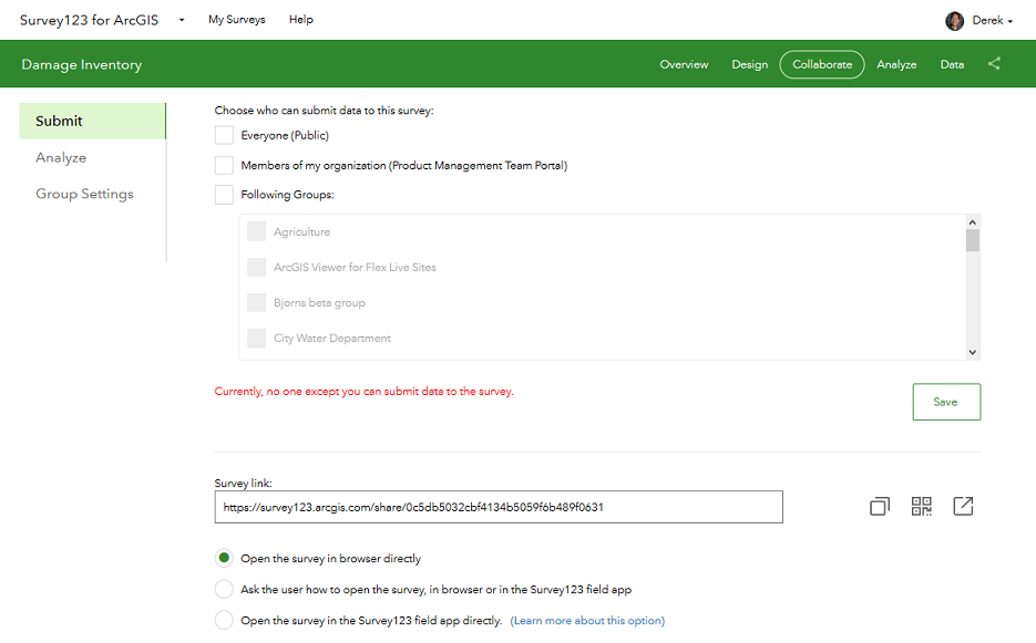

Yes, the workflow you want is fully supported. I recommend that you configure your sharing settings not through the Item Details pages in ArcGIS Online, but through the Survey123 website.
Sign into the Survey123 website with your ArcGIS Online organization account, and you will see all of your surveys listed. Select the survey you want to work with, then navigate to the Collaborate tab.
Survey123 website - Collaborate page
On this page, when you select the Submit tab on the left - this determines who can access, view, and submit responses to your survey.
When you click the Analyze tab on the left, this determines who can view the survey results on both the Analyze and Data pages (both in the upper right corner).

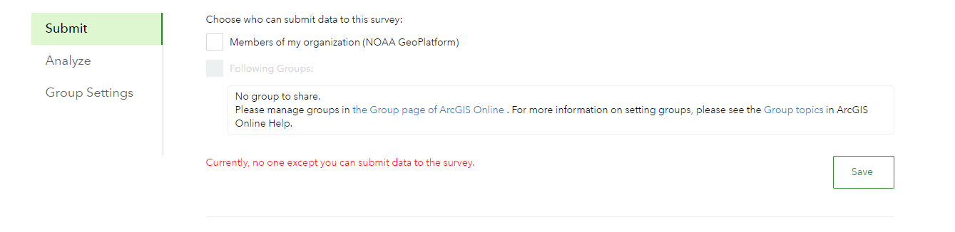

Interesting... I don't have an "Everyone (Public)" option, even though the content is set to everyone on the item details page. Do you think this is a setting set by the organization administrator(s)?

The problem: I cannot access these share settings via Survey123 and the Collaborate section. For both the "submit" and "analyze" sections, I can only choose "Members of my organization," regardless of what the files in "my content" are set to.
