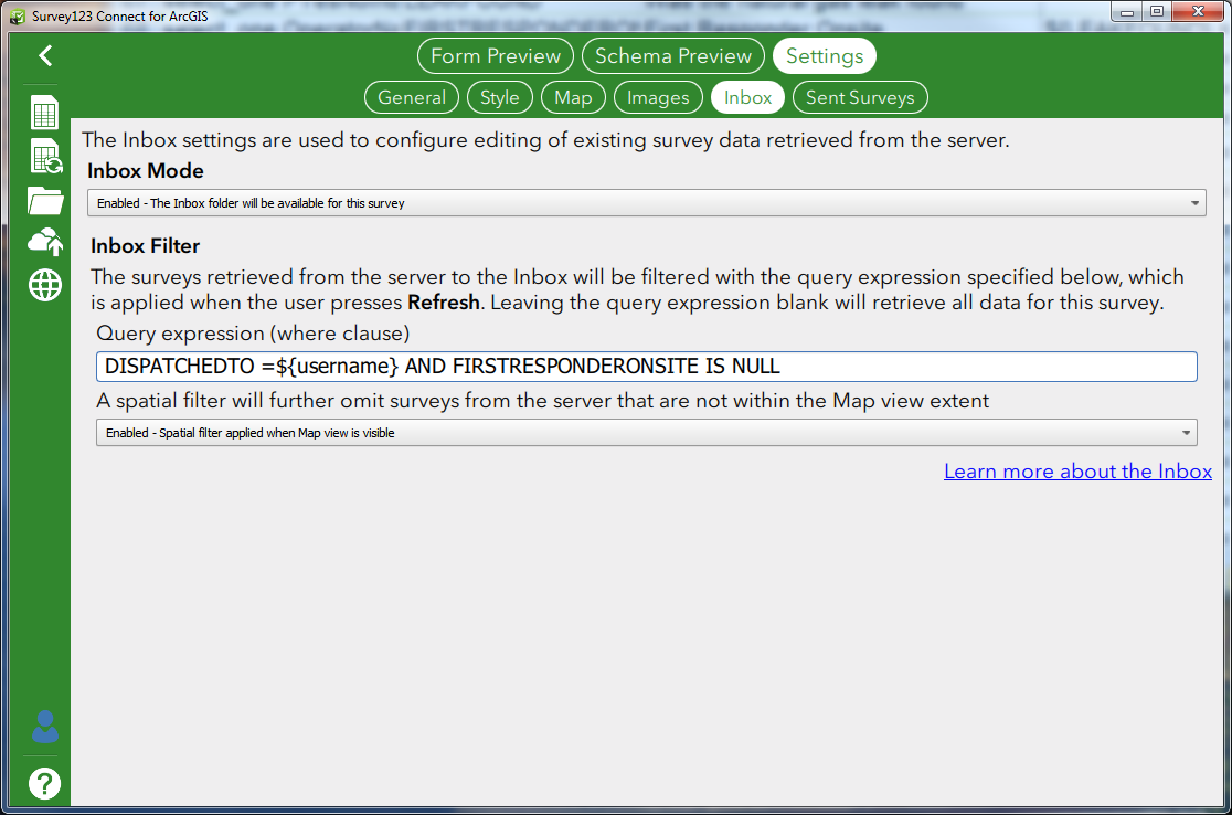

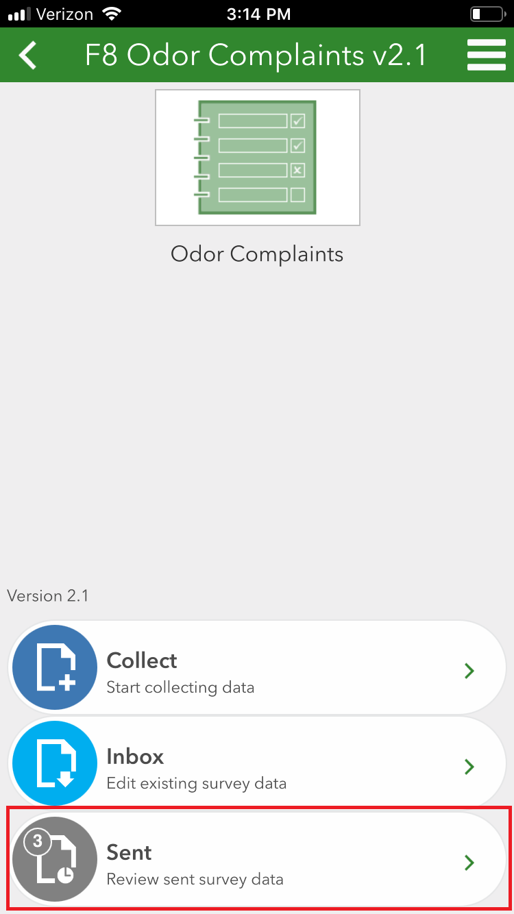

Our secretary created an Odor complaint form this morning for an operator before he left the office. When the operator arrived at the job site he called back into the office to let the secretary know that the address number was incorrect. The secretary went back into her Sent box and edited and resent the survey. She asked the operator to go back into his Survey123 app on his phone and refresh the inbox. When he did that particular form disappeared. For whatever reason going back into the Sent box and editing existing forms disappear completely in the inbox.
Our inbox filter(last image listed below) has no relation to the address box so I assume it has to be a bug.
DISPATCHEDTO =${username} AND FIRSTRESPONDERONSITE IS NULL
Thanks, Jordan

Can you see the data in ArcGIS Online?  I am wondering if the FIRSTRESPONDEONSITE field was updated.  The act of editing should not remove a survey from what should be shown in the Inbox; changing the survey so that the condition that is applied is no longer valid would remove it from the Inbox on refresh.
