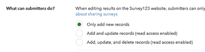

I've had a similar issue on Enterprise for a while. Short-term workaround was a custom Admin Role for other users. Exact same symptoms, but unsure if these issues are related since your set-up was working prior to the update.
In my case, the survey was a public survey set to "only add new records". I think (but can't quite remember) if we set to "Add and update records" it would work normally for non-admin users.
