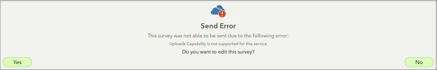

Now, I open Survey123 for ArcGIS in my system,submitted the very first ROW Permit request and I got the below error.
"Upload Capability is not supported for this service"
